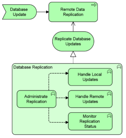

Technology Layer Example
The example below shows, a technology event Database Update triggers a technology process Remote Data Replication, which is served by a technology service Replicate Database Updates.
This technology service is realized by a technology function Database Replication, which is composed of four other technology functions:
  1. Administrate Replication
  2. Handle Local Updates
  3. Handle Remote Updates
  4. Monitor Replication Status.
There are information flows from the Administrate Replication technology function to the other three technology functions.
