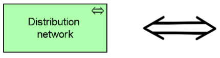

Distribution Network Concept Notation
A distribution network represents a physical network used to transport materials or energy.
A distribution network has the following characteristics:
- A distribution network represents the physical distribution or transportation infrastructure.
- It embodies the physical realization of the logical paths between nodes.
A distribution network connects two or more nodes. - A distribution network may realize one or more paths.
- A distribution network can consist of sub-networks and can aggregate facilities and equipment, i.e. railway stations and trains that are part of a rail network.

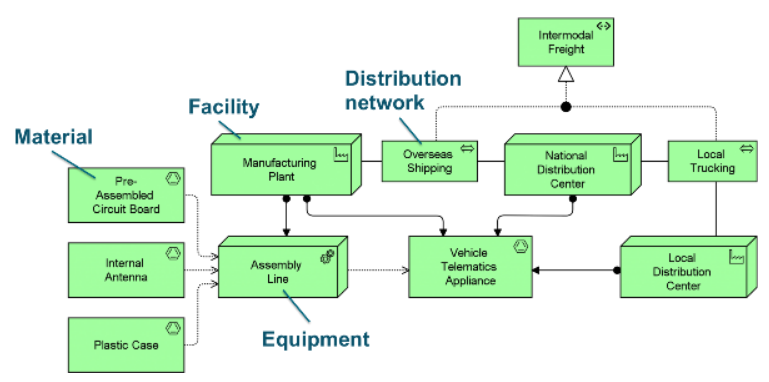

Physical Layer Concept Example
An Assembly Line is modeled as equipment, and installed at a facility Manufacturing Plant, makes use of materials Pre-Assembled Circuit Board, Internal Antenna, and Plastic Case to produce material Vehicle Telematics Appliance.
The appliance is initially located at the Manufacturing Plant facility, is subsequently transported to the facilities National Distribution Center and Local Distribution Center, making use of the distribution networks Overseas Shipping and Local Trucking. These distribution networks together realize the path Intermodal Freight.
