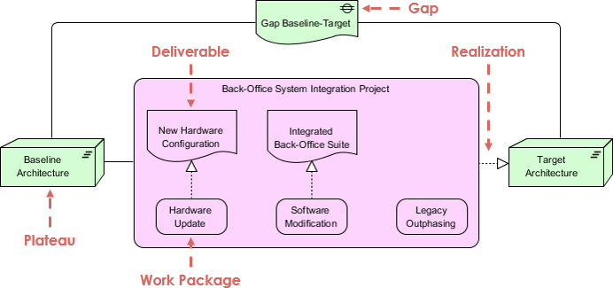

Implementation and Migration Layer Example
The following example depicts a simple example of a business transformation project from baseline architecture to target architecture. There is a gap between them which is elaborated by the back-office system integration project.
The proposed project is modeled by a set of work packages and the corresponding deliverables.
