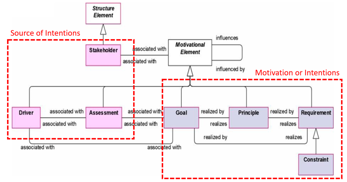

As mentioned in Part I, the metamodel of motivational is an extension in ArchiMate as shown in the Figure below that includes two kind of motivational concepts: 1) Source of Intentions 2) Motivation
There are four motivation elements: 1) Goal, 2) Principle, 3) Requirement, and 4) Constraint

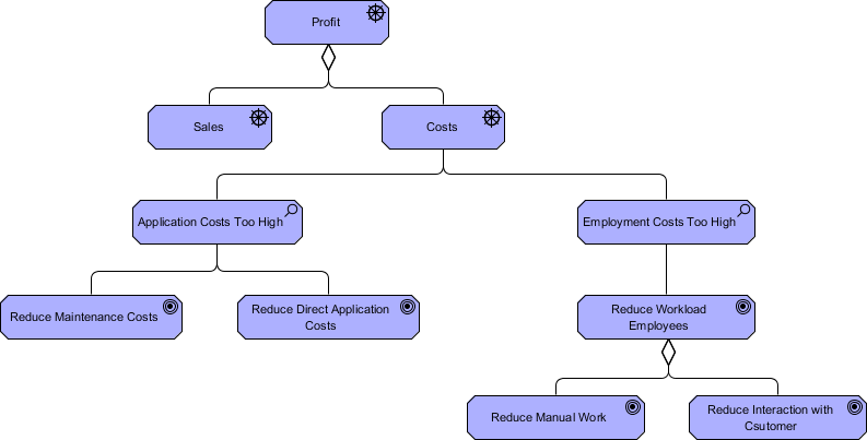

Example – Goal Concept
The ArchiMate diagram below illustrates the goals for modeling the assessments of the driver Costs:
ArchiMate Goal Example
  • The applications costs and the costs of employees are too high.
  • The former assessment is addressed by the goals Reduce Maintenance Costs and Reduce Direct Application Costs (of usage).
  • The latter assessment is addressed by the goal Reduce Workload Employees, which is decomposed into Reduce Manual Work and Reduce Interaction with Customer.

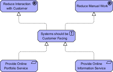

Motivation Concept Diagram Example:
The ArchiMate below illustrates the use of principles:
ArchiMate Principle Example
  • Principle Systems Should be Customer Facing is modeled as a means to realize the goals Reduce Interaction with Customer and Reduce Manual Work.
  • The principle is further specialized into the requirements Provide Online Portfolio Service and Provide Online Information Service to apply the principle to the actual systems (architecture) under design.

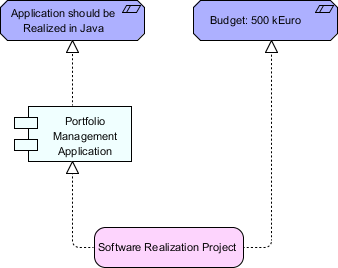

Example ArchiMate Diaram – Constraint
For the realization of a new portfolio management application, two constraints are imposed, as shown in the model below:
ArchiMate Constraint Example
  • In consideration of the cross-platform requirement – the realization of the application Java should be used
  • The budget of the implementation project is limited to 500k Euro
