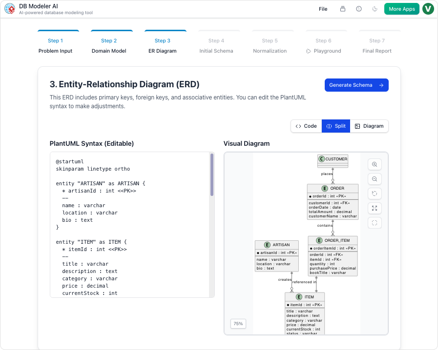

How AI Tools Like Visual Paradigm’s DBModeler AI Simplify Everything
While the manual process teaches deep understanding, it can be time-consuming and error-prone — especially for beginners.
Enter Visual Paradigm’s AI DB Modeler — a browser-based tool that automates the entire pipeline using artificial intelligence.
The 7-Step AI Workflow
Problem Input
Describe your app in plain English:
“I want a bookstore where customers can order books and leave reviews.”
→ AI understands and expands it. -
Generate UML Class Diagram
AI creates a PlantUML-based domain model with classes, attributes, and relationships.
Auto-Convert to ERD
AI transforms the class diagram into a full ERD — resolving M:N relationships, adding PK/FK, and enforcing normalization. -
Generate SQL DDL
Instantly produces executableCREATE TABLEstatements (PostgreSQL, MySQL, etc.). -
Intelligent Normalization
AI checks for anomalies and suggests improvements (e.g., splitting tables, adding constraints). -
Iterate with AI Chatbot
Ask: “Add audit columns (created_at, updated_at) to all tables.”
→ AI updates the model and schema instantly. -
Live SQL Playground & Export
Test queries in-browser, generate reports, export SQL, diagrams, or documentation.
✅ Why It’s Great for Beginners:
No need to learn UML or ERD rules manually.
Avoids common mistakes (e.g., missing FKs, wrong cardinality).
Fast iteration: go from idea to working database in under 10 minutes.
Free trial available — no installation required.
🔗 Access: ai.visual-paradigm.com/tool/dbmodeler-ai
